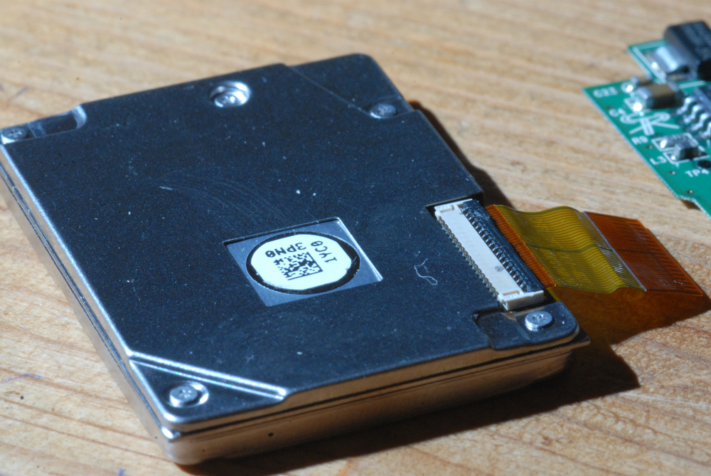

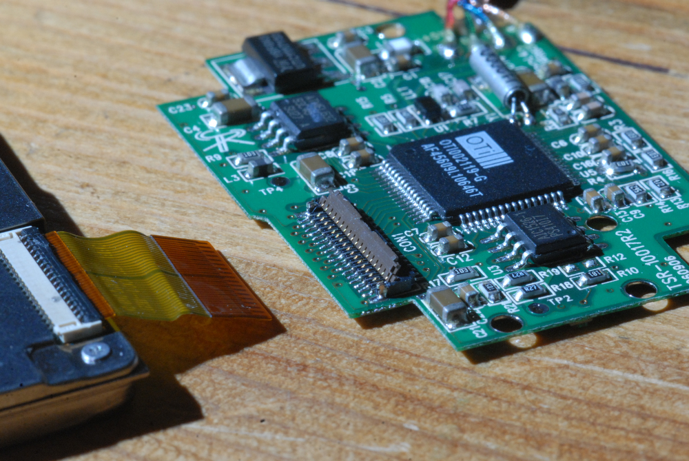

Oh, here are some pix of the connector inside the 12gb USB drive I bought. Should have included these in the first mail.
Carl Hutzler
Thu, 01 Feb 2007 15:26:49 -0800
As you can see, the drive itself is actually about 20% smaller than the CF form factor. The CF connector itself takes up the extra space on the 4, 5, 6, and 8 GB drives. This 12GB drive does not use any "bulky" connectors...instead it has a simple 35 pin ZIF connector which in this USB drive connects to a circuit board which handles the conversion to USB.
Oh well. Wonder what I can create with it now :-)
