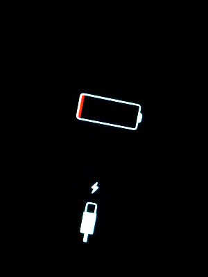

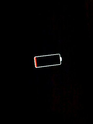

I just got an Apple iPhone 5 recently. I took it on a trip this past weekend and forgotten the proprietary USB cable (why iPhone 5 has it's own special USB cable rather than the standard USB cable is beyond me). On the way back from the trip, the phone rand out of battery and turned off. After getting home, I plugged in the special USB cable and plugged it into the wall. I saw the following symbol on the screen.
Wed, 19 Mar 2014 01:37:14 +0300
I didn't know what that symbol means. It looks like iPhone 5 is telling me that it is low on battery. But it's plugged it. Why isn't it charging? Normally, I would expect to see a thunder bolt or a progress to indicate it is charging.
I pulled out the USB cable and try it again. As I was pulling it out, I saw the following symbol flash by on the screen.
Wed, 19 Mar 2014 01:39:31 +0300
That was interesting. The second symbol actually shows the thunder bolt and the USB cable. Does that mean it is charging?
I plugged the USB cable all the way back in and saw the first symbol. I pulled it out a little bit and saw the second symbol. I left the USB cable pulled out a little bit with the second symbol and let it "charge" for half an hour.
After coming back, the phone still won't powered on. A little frustrated, I decided to plug the cable all the way in, which generated the first symbol. I left it "charging" for a while. The iPhone 5 turned itself on later after it gained enough charge.
So the first symbol is the charging symbol. The second symbol means the USB cable is not plugged all the way in. There is no symbol if the USB cable is unplugged.

I left my phone on last night when I went to bed at 35%. As I woke myself up (fortunately enough as my alarm didn't go off!) I realised that my phone had died last night when I was asleep. I plugged it into the wall and the first symbol came up. I hadn't noticed it before (even though I have had my phone for 1.5 years!), but left it to charge.
Ten minutes later I checked it as all eager phone addicts do, and it still had the same symbol so I unplugged it and your second symbol appeared. I tried blowing inside in case of lint, turned the charger around and nothing was happening.
