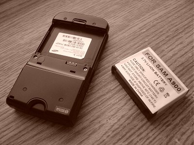

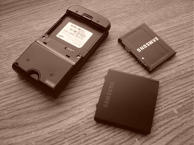

My plan has unlimited calls and web access during off-peak hours, so it is perfect for staying connected. But the battery is small (see photo below) and will be easily drained if I stay on it too long. While traveling, I always carry at least one extended battery.

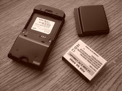

I was a little disappointed to get the Eforcity extended battery without cover. But I figured, I can always use two extended batteries. So I ordered Bargaincell's Brand New Samsung MM-A900 Extended Battery w/ Door (1200 mAh) through Amazon. This battery came even quicker. It was at my door the day after. And it came with a nice extended battery cover (see photo below).

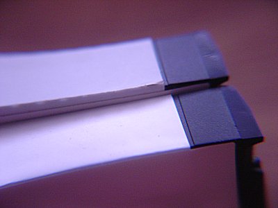

I was happy, now I can use two extended batteries with this cover. So I tried to insert Bargaincell's battery into the phone. But it won't fit!
After playing with the battery for a while and comparing it to the Eforcity battery, I noticed that the Bargaincell battery is too wide (see photo below)!

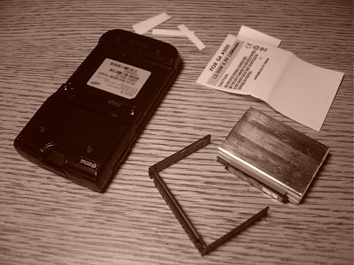

To get the Bargaincell battery to work, all I really have to do is to slim down the sides. I could already think of many ways to do that. But before I pick a method, the first thing to do is to take apart the battery.
As it turn out, as I peeled off the label, I learned that the label is the package. There its two standard batteries wired in parallel under the labels. The front/side plastic rail comes right off (see photo below).

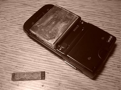

The battery actually works in the camera phone without the plastic rail. But I figured if I just snap off one of its sides, it will fit just fine. And it does as shown in the photo below.

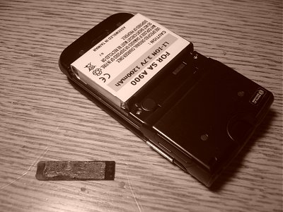

To make the battery more presentable, without exposed contacts, etc., I wrapped the label back onto the battery. The label made the battery's side slightly wider. It's a tight fit, but works nevertheless (see photo below). Now I'm a happy camper . . . with Internet access!
