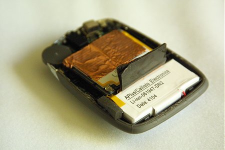

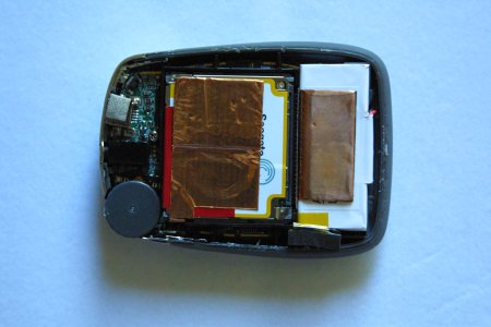

Rio Carbon Internals
Here is a picture of the Rio Carbon MP3 Player guts. Control components on the left, Microdrive in the middle, and the rechargeable Lithium Ion Battery on the right.
Thu, 16 Dec 2004 07:43:06 -0800
Battery . . .
APlus/Callisto Electronics
Li-ion-061947-DN2
Date: 4104
Anyone knows where to get a replacement if this one ever goes out?

I have a Rio Carbon 2.5 GB and it stopped working. I opened it and replaced the Li-ion battery with a 4,8 power source and it worked. I wanna know where can I get a new Li-ion battery so I can replace the other one.

I've been working on a friend's old Rio Carbon Pearl on and off for several months, and today I surmised the Microdrive was dead. I went and picked up a Sandisk Ultra II Compact flash card, hooked it into the Rio and flashed the firmware to 1.43 and the player booted up flawlessly. I can not guarantee this will work w/ all CF cards, but I had no problem. Strike "Because the drive has to be operating in True IDE Mode, the following CF storage devices cannot be used in the Rio Carbon:
* Any solid-state CompactFlash memory " from Chieh Cheng's earlier post, as it is obviously wrong. Don't be afraid to experiment ladies and gents, most places have a pretty liberal return policy if you can't get it to work.

I found a Rio Carbon with a dead battery. To test I removed the old battery and replaced it with an "exterior" 3xAA battery holder. I am using 3 AA Ni-Mh rechargeable batteries. So far the batteries have lasted 6 hours of playback. It looks ugly and it's big but it proofs the idea. Any 3.7V battery (3 x 1.2V too)would work.
I am looking for a Li-ion battery to replace the original one. There's nothing that small in the market, so I am thinking to use an iPOD one ($12) and "mount" it outside the player.
I'll post more details as I go further.

And, this is what I found inside my player:
Microdrive:
Hitachi HMS360606D5CF00
Battery:
Li-ion-061947-DN2-UL
Date: 2105

Tue, 02 Sep 2008 19:50:02 +0000
I put in a Sandisk Ultra II Compact Flash 2GB, and it works perfectly!
I've had four different Carbons, and I haven't been able to use any of them more than approximately five hours before having to charge them again. But after putting in the flash card, I installed the unofficial firmware "Developer's Cut 3.04", switched the dB limiter off, and let it play at highest volume until it died. The battery lasted for more than 15 hours! Two other good things: Transferring files goes faster than before, and the card doesn't get warm.
(Note that you have to reinstall the firmware when putting in a new disk/card.)
