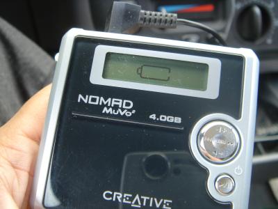

Here is a picture of the big empty battery symbol on the MuVo^2.
