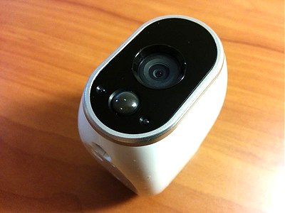

The Arlo HD Security Camera VMC3030 looks very futuristic. Its laboratory white body and black face reminds me of characters in recent robot movies, like "I, Robot", "WALL-E", "Big Hero 6", etc. Aesthetically, it's nothing to rave about, but it's definitely a huge improvement compared to traditional, clunky, boxy video camera. Compared to the black dome security cameras of the modern age, the Arlo white/black cameras look more futuristic.
These cameras produce 720P HD quality videos. That could be considered as overkill for video surveillance around your home. But with wireless cameras this small, it makes you wonder if you could use it as an action cam around your home as well. The lens captures 130 degrees field of view, which is on par with many action cams on the market. It is fixed focus from 2 feet to infinity.

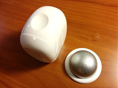

Arlo cameras come with metallic ball-like magnetic mounts. Using it, you can place the Arlo camera in any position on this half-dome layout. It's an ingenious innovation created by Avaak for its Vue security camera system, which Netgear purchased. Netgear turned the Vue into VueZone, which is similar to the Arlo. But only the magnetic camera mount is reused in the Arlo line.
The magnetic camera mount is quite handy for use indoors, because you can quickly and easily pull the camera off for battery change or temporary relocation. The magnet seems strong and firm. A future California earthquake will let me know if it is strong enough.

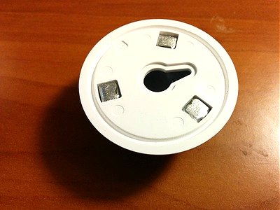

At first, I thought the magnet is in the ball mount. But in reality, the dome is just metal. The magnet is in the camera. Therefore, it's actually possible to attach the camera to other metal surfaces.
The half dome mount is attached to flat surfaces much the same way as photo frames. You fasten a screw (include) to the wall and hang the dome mount on it (see interface in the photo below). The screw has a #1 Phillips screw head, smaller than the standard #2 driver.
I was a little skeptical of the wall hanging interface. But after fastening the screw to the correct distance, the mount slides on with enough friction to hold it in place. Now I have the confidence that the dome mount isn't just going to come off with a same shake.

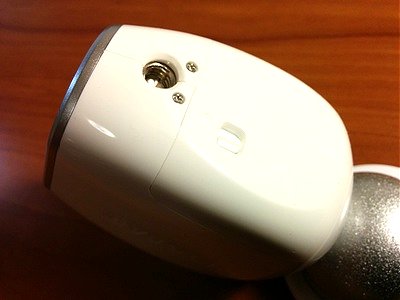

But if the magnetic mount is too restrictive for you, you can use the tripod screw mount below the camera. Then you can use practically any tripod camera bracket on the market. I'm glad Netgear did not skimp on this feature.

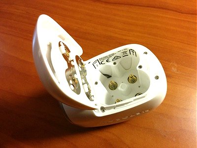

The Arlo camera is completely wireless. That means they are powered by batteries. The battery compartment is on the bottom of the camera. There is a self locking switch that you push to unlock. Then you slide the cover to open it. The cover is on a hinge, so you won't drop it when replacing the batteries on a ladder. The photo below shows the battery compartment.
Each Arlo camera is powered by four CR123 batteries. New Energizer batteries are included in the package. Each batteries supply 3 volts. Four of them provide 12 volts total. The CR123 batteries are necessary to provide a camera package this small. Using eight AA batteries means the Arlo camera has to be bigger.
One of my biggest concerns with electrical gadgets today is whether they work with rechargeable batteries. Fortunately, Netgear Arlo cameras work with rechargeable batteries. The form-factor for CR123 size batteries are RCR123A and 16340, so look for this size battery with either Li-Ion or LiFePO4. Netgear specifies at least 650 mAh and as much as 2000 mAh. It's unclear why you can't get even higher capacity batteries. Netgear Arlo cameras can handle battery voltage up to 4.2v.

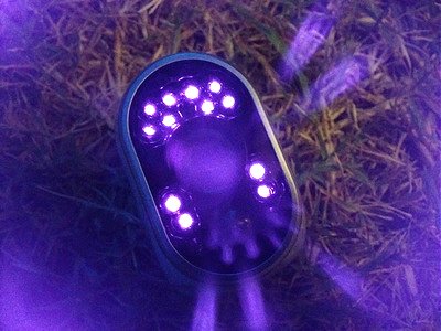

The Arlo HD Security Cam has build in 850nm infrared (IR) LED's. Its digital sensor is also sensitive to 850nm IR light. When it switches to night vision mode, you can hear an audible click. That's the camera moving the IR filter in and out. During daylight, it moves the IR filter in front of the lens. At night, it moves the IR filter out of the way and turns on the IR LED's. The photo below shows the LED's around the face of the camera.
IR Recording Trick
While the cameras were on being tested on the "bench", my kid grabbed one and slammed it down. That caused the IR filter to slide out of the way. The camera operated in daylight mode at the time, so all the recording are redish/pink. So if you ever want to experiment with IR photography, you can try this trick.

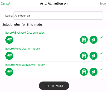

Unlike traditional security cameras that is always recording video, Arlo HD Security Camera has built in motion detector. When there is no motion, the camera stays in low-power battery conservation mode. Once it detects motion, it wakes up and starts to shoot videos. When used in this manner, Netgear claims that fresh new batteries lasts 4 to 6 months.
You can quickly enable and disable all or parts of the motion using various rule sets (see screen shot below). Arlo software provides the all disable and all enable rules by default. You can easily create custom rule sets.

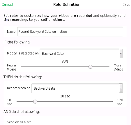

By default, it records 10 seconds of video at a time. You can configure it through software to record between 10 seconds and 2 minutes (see screen shot below). Once Arlo camera detects motion, it starts to record video based on the amount of time you specified. Once the time is up, the Arlo camera stops recording until the next trigger.
Having to guess how long to record is going to be hit and miss. It means you have to anticipate the kind of crime that is going to occur some time in the future. I wish Arlo provides a mode that allows you to continue to record as long as motion is detected. Then when there is no motion detected, it automatically stops recording.
Arlo interface provides a sensitivity setting. It's ranged from "Fewer Videos" to "More Videos" (see screen shot above). The default is 80%.

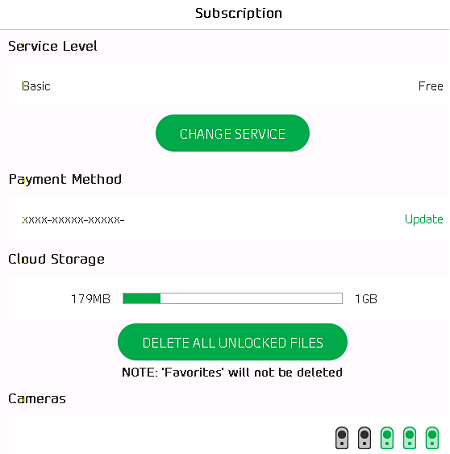

Netgear Arlo is designed around Netgear's cloud recording service. That means all the video clips goes out to Netgear Arlo server before it comes back to you. That translates to remote off-site storage right off the bat, so you don't have to move any data off site yourself. And you don't have to maintain on-site recording equipment. This feature guards against criminal who tries to destroy on-site evidence and arson that could destroy on-site recording.
However, it means you are stuck with Netgear's Arlo cloud service without any other choice. Netgear provide three service levels. Fortunately, its "Basic" service is free. The "Basic" service includes 1 GB of cloud storage, recording of 5 cameras, 1 base station, motion detection alerts, smart mode and rules, download and share video clips, and access from iOS, Android, and desktop. Arlo's web site claims the 1 GB of cloud storage is sufficient for 7 days of recording. I suspect that's enough for most home users. If your home is robbed and you can't get to your remote video storage to download the evidence within 7 days, then you probably need to pay for a higher level service. You can see how much storage you have left from the "Subscription" page (see screen shot below).

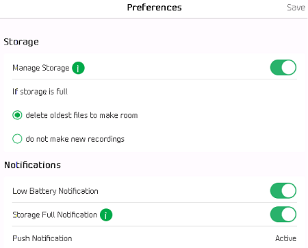

When the storage is full, Netgear server can send you notification (see screen shot below). You can tell the Netgear server to automatically "delete oldest files to make room", which is useful when you use it as a security camera system 24/7. But I am not sure yet on how that plays with "Storage Full Notification".
To get more storage, recording from more cameras, and connecting more base stations, you'll need its "Premier" or "Elite" service. "Premium" service provides 10 GB of cloud storage and recording from 10 cameras. Currently, "Premium" service costs $9.99 per month or $99 per year. "Elite" service provides 100 GB of cloud storage, recording from 15 cameras, and connection from 3 base stations. Currently, "Elite" service costs $14.99 per month or $149 per year. Both "Premier" and "Elite" services also provide scheduler and camera sharing.

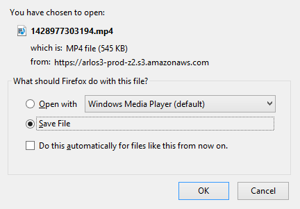

The first time I tried to download multiple videos I got forty something dialogs on the screen. After clicking "OK" and "Save" buttons that many times, I decided to write an Autohotkey script to automate that process.

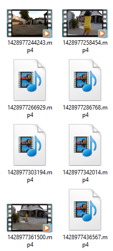

Notice that video files are stored on Amazon AWS servers. The file names are big numbers. Turns out that the file name is the system time stamp in milliseconds since epoch. That's a lot of computer jargon in one sentence. Basically, the file name is the time stamp, but not in human readable form.
The first night, I tried to download the videos recorded during bench testing, involving my kids. Three fourth of the time, it downloaded a MP4 file that is not playable. But if I downloaded it again, it was fine. I noticed this problem after downloading a whole folder of videos only to find out that most of them are not playable. The following screen shot showed folders containing playable files and non-playable files. But the next night, all the video downloaded fine the first time. So it was probably server outage.

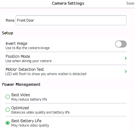

Video Quality / Power Management

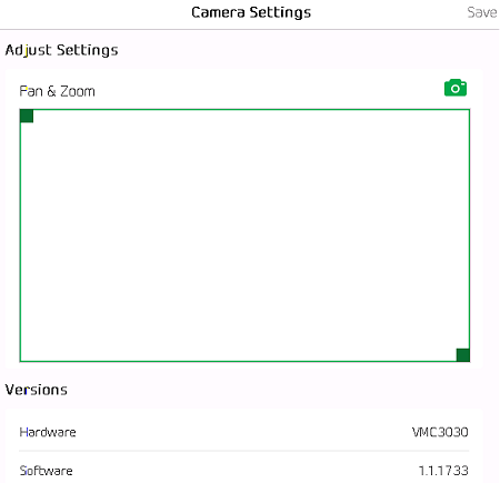

Pan & Zoom
