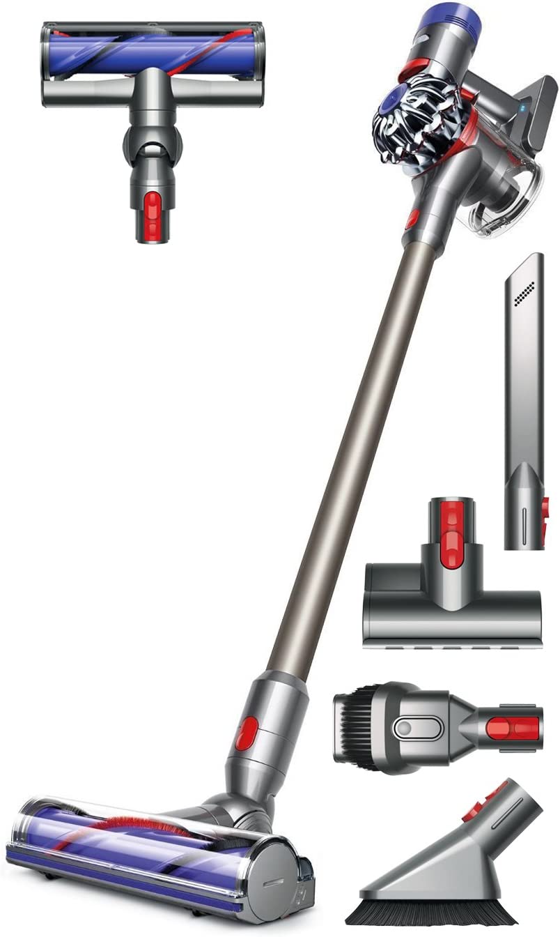

Dyson V8 21.6V Vacuums Battery Conversion Guide
