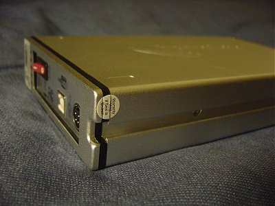

Before disassembling your own HybridDrive, note that you will void the warranty sticker that is on the bottom of the drive (see photo below).
After you've gotten over the warranty issue, use an X-acto knife to slice through the warranty stick along the aluminum/plastic seam. You'll need to make two cuts, one for each seam.

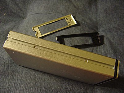

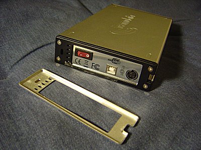

When you are done with the sticker, carefully peal off the aluminum back (see photo below). Be careful, because the aluminum back panel is a very thin piece of cover. If you don't want to keep it, then you can be as rough as you like. But I think the back aluminum cover looks cool and makes the external drive look whole.
Pealing off the aluminum cover, you'll uncover four screws. Unscrew these screws and remove the black plastic cover. Then locate the two small screws under the drive case (see photo below). If you have the vertical stand attached, you'll have to remove it first to find the two small screws.

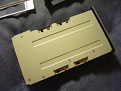

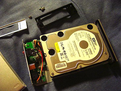

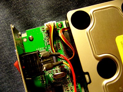

Be careful while unscrew these small screws as the internal components will slide out from the front when you are done. The photo below shows the internal components.
The hard drive inside is a Western Digital WD5000AAKS Caviar SE16. It is connected via the 16-bit USB control via SATA.
To remove the hard drive, you'll have to unscrew the circuit board first. There are three small screws fastening the circuit board to the metal bracket. Two of the small screws are shown in the photo below.
After removing the three small screws for the circuit board, turn the metal bracket over. You'll need to unscrew the four screw shown in the photo below.
After removing the screws, the hard drive can be detached from the USB circuit board and removed from the bracket.

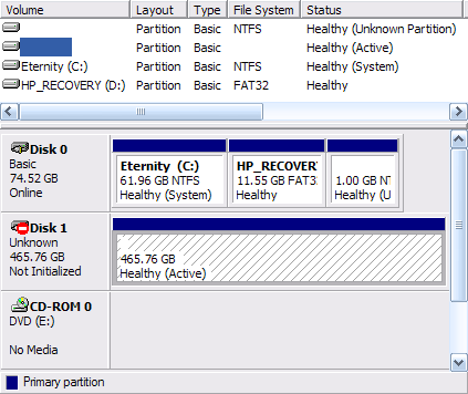

Does the 500 GB Drive Work Without the Case?
Next, I decided to see if the 500 GB FAT32 drive shows up in Windows Explorer when connected via another SATA/USB interface. I used the "Sabrent USB 2.0 to IDE/SATA Cable" to connect the 500 GB SATA drive to my computer. No drive showed up. Looking at the partition, I see an unknown partition. Apparently AcomData used a proprietary partition to hold the virtual CD partition (CD PART) and the FAT32 partition (HD PART).
I know I can repartition the drive, but that means the drive will not work inside this USB enclosure ever again. So that's not an option.
