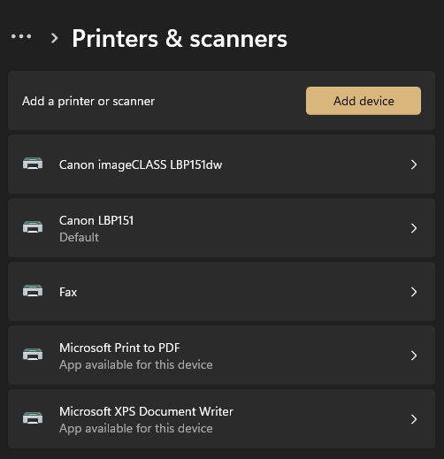

On your Windows PC, open up "Settings". You can do that by right-clicking on the Windows menu icon and then click on "Settings". Now, click on "Bluetooth & devices". Then click on "Printers & scanners". Finally, click on the "Add device" button as shown in the screen shot below.

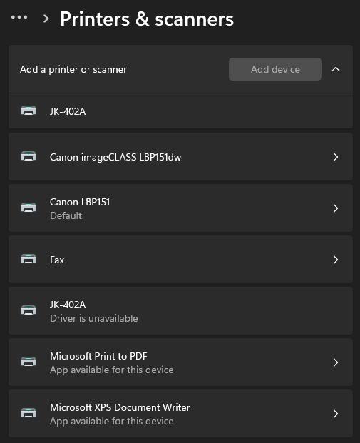

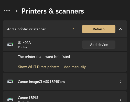

If Bluetooth is enabled on your computer and the printer is turned on, you should see it show up. The screen shot below shows my computer sees the JK-402A Bluetooth Thermal Label Printer.

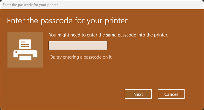

Click on the "Add device" button next to the Bluetooth printer. The computer will spend a few seconds communicating with the printer via wireless Bluetooth. Then you will see the following dialog asking for a passcode for the printer.
The passcode for the JK-402A Bluetooth Thermal Label Printer is "0000". Refer to the user manual of your printer for the correct passcode. Enter the passcode and click on the "Next" button. Windows will spend about half a minute pairing with the printer. When it's done, you'll see that the printer has been added to the list like the screen shot below.
In the case of the JK-402A, Windows could not find a driver for it and states that "Drive is unavailable". That's ok, because this is just the pairing step. We'll need to install the driver in the next step.

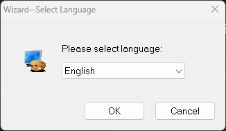

The JK-402A printer's driver installer is called "KCPrinterSetup.exe". Your printer's driver installer may be named differently. Double-click it to launch the installer. After launching, the installer will ask you your preferred language as shown in the screen show below.

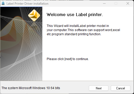

Of course, select the language of your preference and click the "OK" button. The next screen is just an introduction and not very useful (see screen shot below). Just click the "Next" button to get on with it.

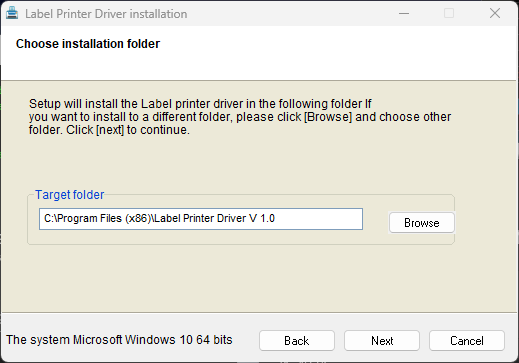

The next screen asks you to choose installation folder. A default path will be provided as shown in the screen shot below. If you have a better installation location, you can enter it, then click "Next". Otherwise, just go with the default and click the "Next" button.

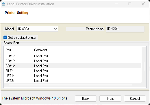

The next screen presents you with printer settings as shown in screen shot below.

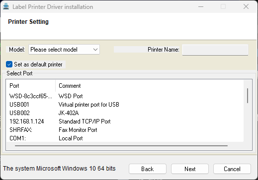

You'll select "JK-402A" for "Model:". Although the screen shot shows "USB002 JK-402A", do not select that. It shows up on a USB port because I had installed the printer as a USB printer prior. Instead, most Bluetooth printers are attached virtually via COM4 port. Therefore, select the "COM4: Local Port" option as shown in the screen show below. You can change this COM port later; see the "Cross-Reference" below. Finally, click the "Next" button to continue.

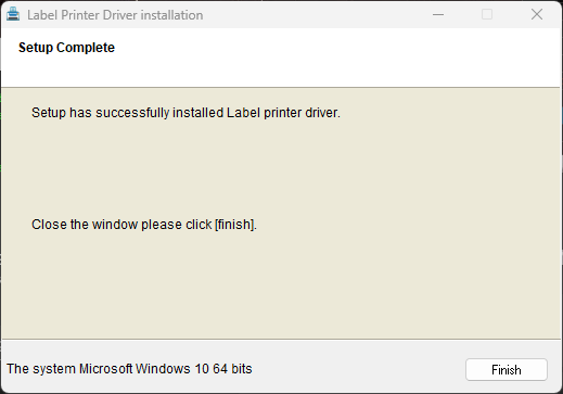

The installer will proceed to install the driver for the printer. When it's done the setup complete screen will be presented as shown in the screen shot below. Click "Finish" to complete the driver installation.

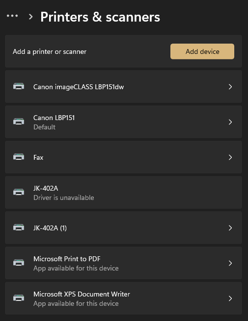

On the "Printer & scanners" page, you'll now see a new printer entry as shown in the screen shot below. Normally, this printer driver will also be named "JK-402A". But in this case, it's name "JK-402A (1)", because I had installed it prior.
You can ignore the "JK-402A Driver is unavailable" entry, but do NOT delete it. That entry is the physical device pairing. It's absolutely needed. If you delete it, then you'll have to start the installation all over again. Continue to the next section to configure the printer driver and change its name.

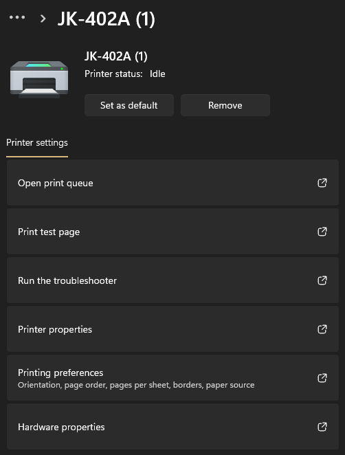

To configure the printer driver, click on the "JK-402A (1)" entry. You'll see the screen below.

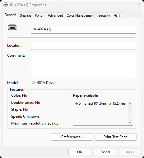

Click on the "Printer properties". You'll be presented with the Properties dialog as shown in the screen shot below. You'll be able to change its name and other settings here. A year from now, I may not remember which printer is "JK-402A", so I definitely want to change it to something more descriptive like "JK-402A Thermal Label Printer". You can enter it in the text box next to the printer icon and push "OK".

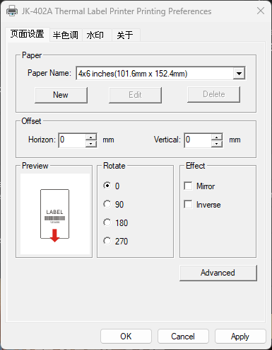

Next, click on "Print preferences" from "Settings". You'll be presented with a dialog below. The printer is a 4"x6" label printer. So select "4x6 inches(101.6mm x 152.4mm)" from the pull down next to "Paper Name". Once satisfied, click on the "OK" button.
You have just completed the Bluetooth thermal label printer set-up. Now you can start printing label from your Windows computer via wireless Bluetooth.
