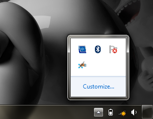

On your Windows 7 computer, click the up arrow on the task bar. Find the Bluetooth icon. That's the middle icon of the top row in the screen shot below.

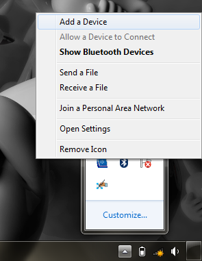

Click the Bluetooth icon to bring up a pop-up menu as shown in the screen shot below. Click "Add a Device" from that pop-up menu.

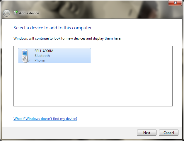

On the "Add a Device" screen, Windows 7 will search for your Bluetooth-enabled phone. When it shows up, select it (see screen shot below) and click "Next".

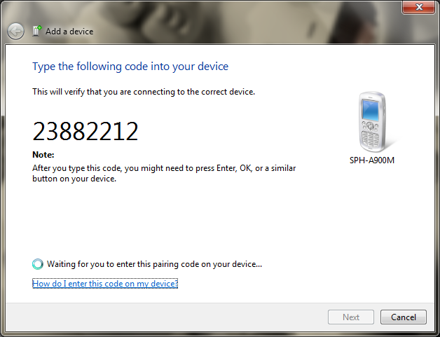

On the next screen, Windows 7 will give you a random pairing code. The screen shot below shows the random code that I was given when I paired my phone with my computer. Your random code will be different from the code shown below. Enter the code into your A900M cellphone and then press the "OK" button.

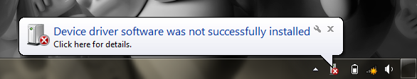

Once pairing is successful, Windows 7 will attempt to install drivers for your phones. But it will shows "Device drive was not successfully installed" error message. But you do not need to worry. Windows 7 does not need the device driver to tether to your phone.
At this point, your phone and your computer are paired. That means they can recognize each other. In the next section, you will set-up the network connection so that Windows 7 can connect to the Internet through your phone.
