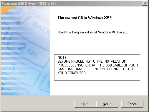

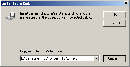

Installing the driver software is easy. Open the "Samsung (MCCI Driver 4.16)" folder. Then click on "setup.exe" to run the software. The first screen might surprise you; it says, "The current OS is Windows XP !!" (see screen shot below). Ignore that message and click on the "Next >" button. Finish the installation process by clicking "Next >" and "Yes" all the way through.
At the completion of the installation, the setup software asks you to restart your computer. You can either do it right then or do it later at your leisure. I've found that I didn't have to restart my computer at all to install the phone and complete the rest of the set-up process. But to avoid any additional problems you might encounter, restart is always a good advice.

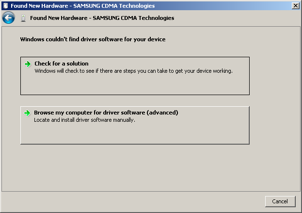

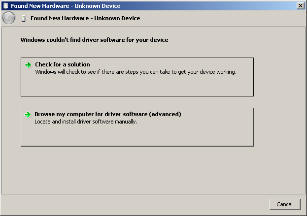

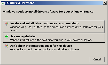

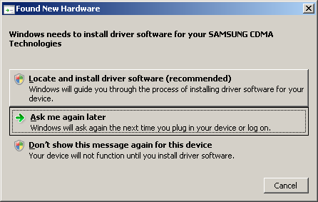

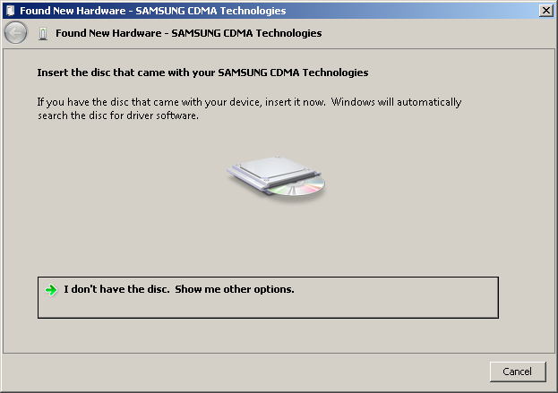

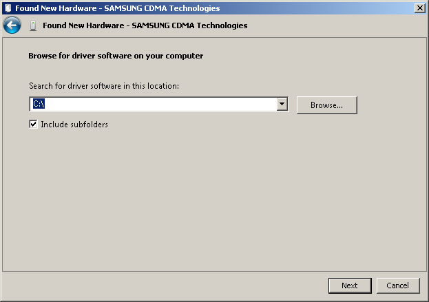

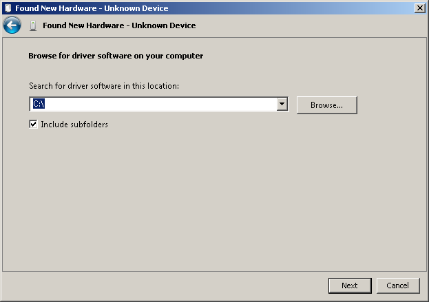

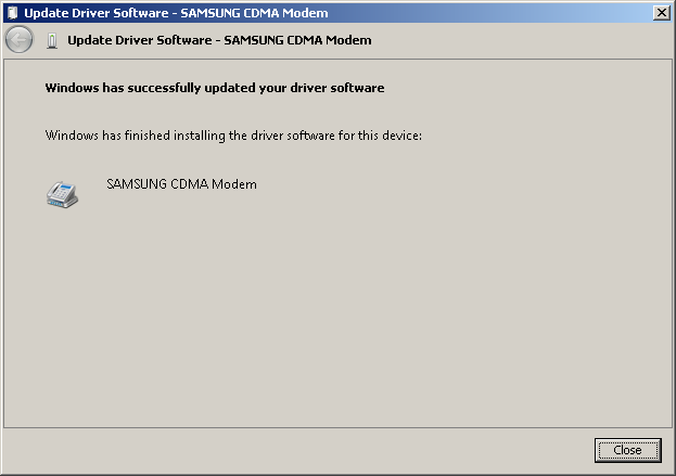

After picking the USB port you want to use, plug the USB cable into the phone and then into the computer. The "Found New Hardware Wizard" will pop-up soon after as shown in the screen shot below. Choose "Locate and install driver software (recommended)" as shown in the screen shot below.
