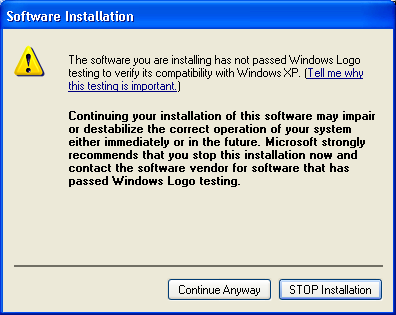

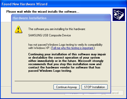

If you are running Windows XP, during the installation, you are going to see a dialog box that says, "The software you are installing has not passed Windows Logo testing to verify its compatibility with Windows XP." (See screenshot below.) You are going to see this dialog box three times. Simply click on "Continue Anyway" each time.

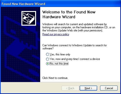

After picking the USB port you want to use, plug the USB cable into the phone and then into the computer. The "Found New Hardware Wizard" will pop-up soon after as shown in the screen shot below. It will ask you whether to "connect to Windows Update to search for software?" Choose "No, not this time"; you have already downloaded and install the software in the previous steps.

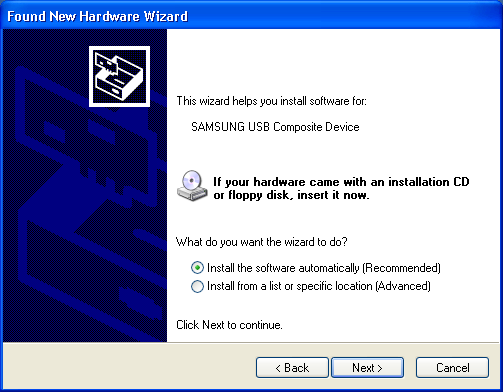

Next, Windows will ask if it could install the "SAMSUNG USB Composite Device" automatically (see screen shot below). Choose the first option.
Windows will warn you that the "SAMSUNG USB Composite Device" driver has not passed the Windows Logo testing (see screen shot below). Ignore this warning and press "Continue Anyway" to proceed with the installation.

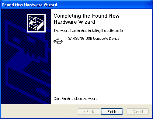

After installing the driver, you will see the wizard completion dialog shown in the screen shot below. Click "Finish".

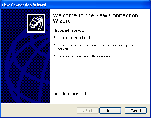

After connecting the phone to your computer, you now need to set up a network connection to access the Internet at broadband speed. Click on the "Start" button and select "Control Panel". Double-click on "Network Connections". From the panel on the left, click on "Create a new connection". Windows will greet you with the "New Connection Wizard" as shown in the screen shot below. Click the "Next >" button to continue.

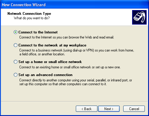

Windows will ask you about the "Network Connection Type". Select "Connect to the Internet" (see screen shot below). Click on the "Next >" button to continue.

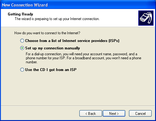

In the "Getting Ready" dialog box , select "Set up my connection manually" (see screen shot below). Click on the "Next >" button to continue.

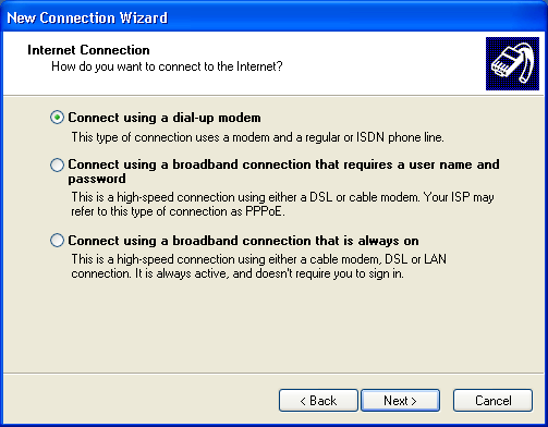

In the "Internet Connection" dialog box, choose "Connect using a dial-up modem" (see screen shot below). Click on the "Next >" button to continue.

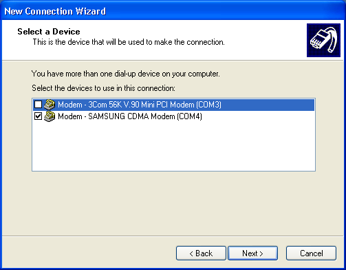

In the "Select a Device" dialog, check the "Modem - SAMSUNG CDMA Modem". Uncheck all other modem devices that may also show up in the list (see screen shot below). Ignore the "(COM4)" that showed up on my computer. It could be a different COM port on your computer. Click on the "Next >" button to continue.

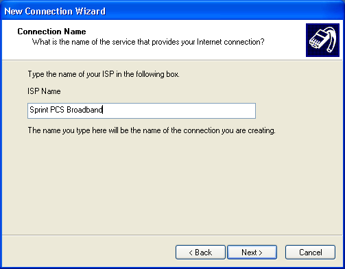

In the "Connection Name" dialog box, type in any connection name that you are comfortable with. I use "Sprint PCS" to indicate that this is a connection through the Sprint PCS service. I added "Broadband" to the end, because I have an older Sprint PCS cellphone that I can connect to, which connects via slower non-broadband speed. Thus, the name helps me figure out which cellphone I'm connecting with. Click on the "Next >" button to continue.

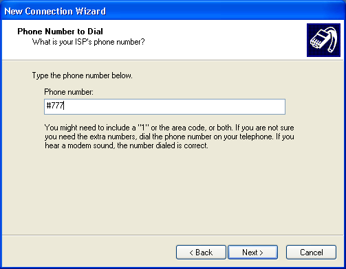

In the "Phone Number to Dial" dialog box, type in "#777" as shown in the screen shot below. Click on the "Next >" button to continue.

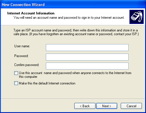

In the "Internet Account Information" dialog, uncheck the only two check boxes (see screen shot below). They are "Use this account name and password when anyone connects to the Internet from this computer" and "Make this the default Internet connection". Leave the "Username" and "Password" fields blank. Click on the "Next > button to continue.

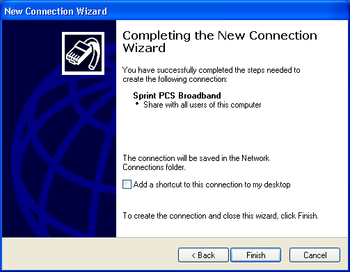

Now you are all done. In the final dialog box, you have the option to "Add a shortcut to this connection to my desktop" (see screen shot below). When you do, you will be able to easily access the network connection conveniently. Click on "Finish" to complete your dial-up set up.

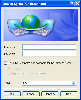

To connect your cellphone and your computer to the Internet, open up the "Network Connections" from "Control Panel" again. Double click on the new network connection you have made in previous steps. If you have already created a short-cut for it, you can skip the "Control Panel" step and double-click that directly. The following dialog will pop-up on your screen.
Do not fill in the dialog with any additional information. Simply click on the "Dial" button and you will be connected to the Internet.

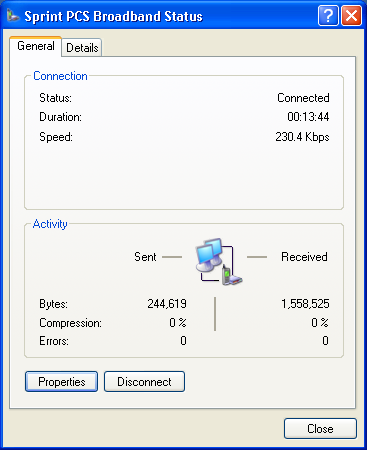

To disconnect your computer and your cellphone from the Internet, find the network connection symbol on your Windows Taskbar. The little icon on the right-hand side of the Taskbar (see screen shot below). It looks like two computer monitors. It will not have a red 'x' on it, meaning it's connected.
Once you find it, click on the network connection icon. It will bring up the status dialog as shown in the screen shot below. There is a "Disconnect" button on it. When you click on this button, you will disconnect the phone and the computer from the Internet.
