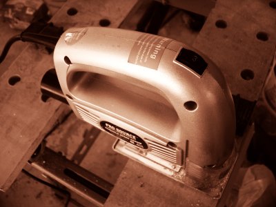

As mentioned before, the scoring knife provides an undesirable result when used on large sheet of plexiglass. The next option is to use a powered-electrical tool to cut the sheet. A table saw might be a better idea, since you can cut in a straight line pretty easily. But the cost of ownership and the amount of storage space needed, puts it out of the reach of myself and many other home owners. After considering price and physical size, the jigsaw seems to be the best choice.
After reading various plexiglass handling documentations online, I bought a variable-speed jigsaw from a local outlet for $20 (see photo below). The variable-speed is important because if the jigsaw is too slow, it will crack and break the plexiglass. On the other hand, if it is too fast, the saw blade will create too much heat and friction and melt the plastic plexiglass.

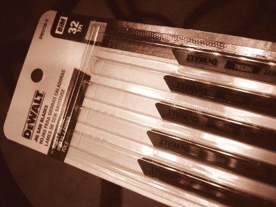

You'd think that manufacturers would sell a whole assortment of tools specifically for cutting plexiglass. But they don't. After researching a bit, I have found that there are few jigsaw blades available specifically for cutting plexiglass. However, the nearest shop that sells such a blade is in England! Luckily many folks have good experience with fine toothed sheet metal jigsaw blades.
I found that the DeWALT 32 TPI Jig Saw Blades (see photo below) worked extremely well. Originally, I bought a set of assorted inexpensive blades from the local Harbor Freight. Unfortunately, this set of blades do not work, because they were coated with paint. The paint created heat and friction, which caused the plexiglass to melt. The DeWALT 32 TPI Jig Saw Blades, on the other hand, is uncoated and worked extremely well for cutting plexiglass.

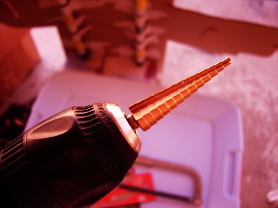

The Drill Bit
If you are planning on cutting the plexiglass from the center, or if you just want to cut a shape, you'll need to drill a pilot hole as big as the jigsaw blade. It's very difficult to drill a plexiglass with regular drill bit. To do it successfully, if at all possible without cracking the plexiglass, you'll have to go from the smallest drill bit to the bit that is the right size. Any jump in drill bit sizes will usually cause the plastic plexiglass to crack. An easy way is to get a step drill bit (show in the photo below). With a step drill bit, I've been able to drill any sized holes in the plexiglass without any cracking it.
