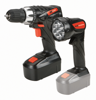

Drill Master 18V system uses a Ni-Cd battery pack. The power tool is completely analog, so the power tool can be driven at almost any voltage as it only affects the power and speed. Higher voltage then the rated 18V may damage or wear out the motor prematurely. 18V / 20V lithium ion battery pack will work on it just fine. But be careful using unprotected lithium battery packs; you don't want to drain the battery pack completely down.
