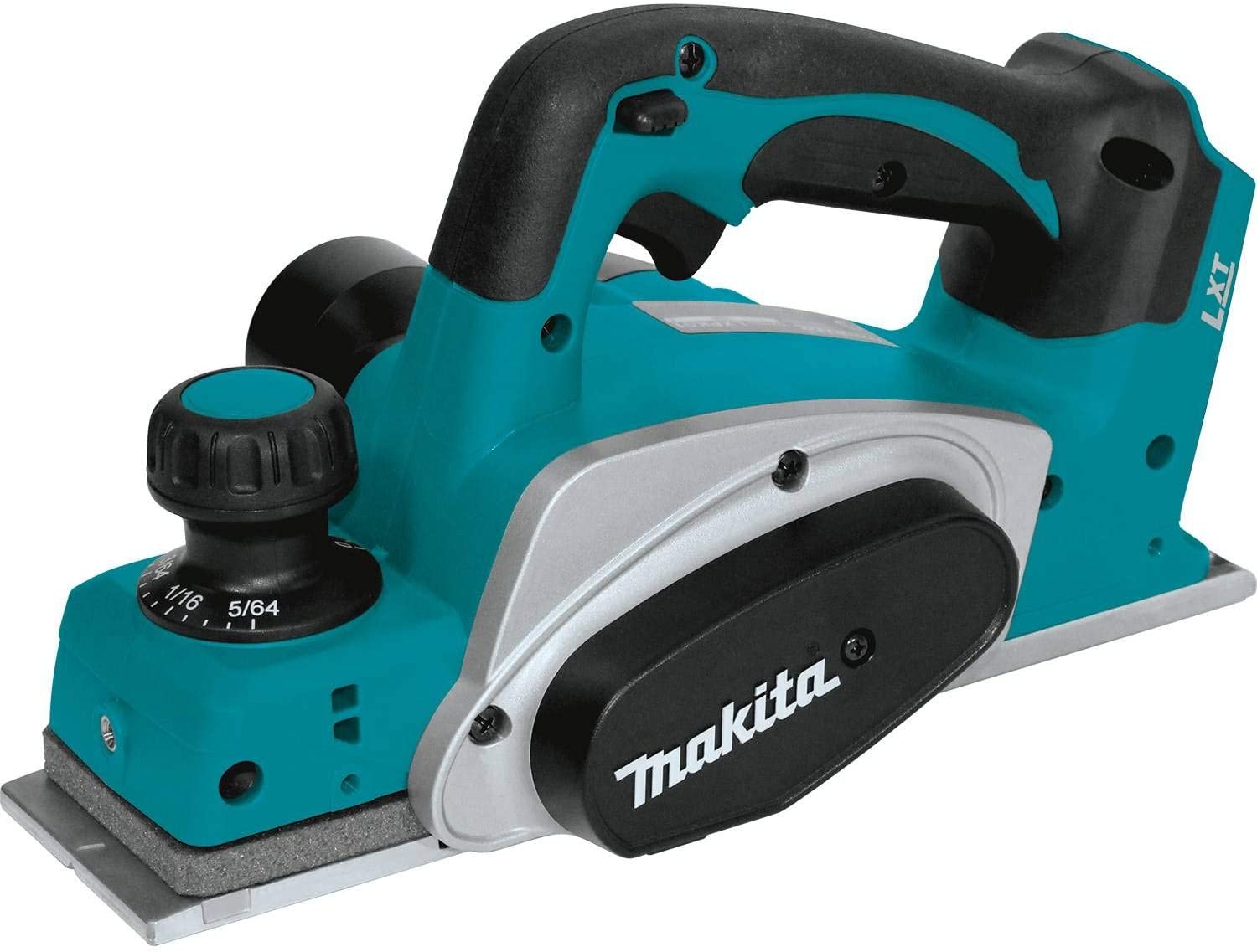

Makita 18V LXT Power Tools Battery Conversion Guide
Looking for a Makita 18V LXT battery adapter to use other brands' battery packs on your Makita 18V LXT power tools? You came to the right place. This page provides recommendation of battery adapters and various methods for you to do just that.
