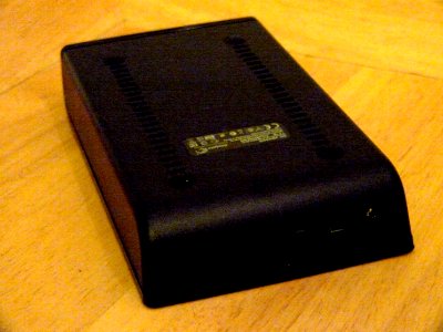

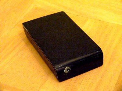

The Seagate Expansion External Hard Drive has a really sleek case. It looks great but takes up a bit more room than other external hard drives on the market. Unfortunately, it's neat shape doesn't really allow for vertical placement.
On the back of the hard drive enclosure is a power port, an USB port, and a lock port.
There are no screws anywhere on the case. They are not under any rubber feet, nor are they under the label. Instead, the case is snapped together with locking tabs.
Use a small flat-head screwdriver to pry between the seams on the bottom of the drive. Because they are locking tabs, you will break off several, if not all, of the tabs to open the case. Apparently Seagate had made this enclosure non-serviceable.

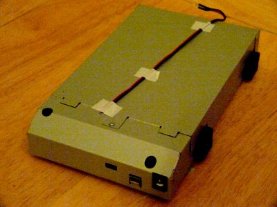

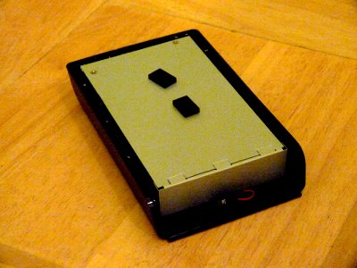

Inside the large plastic enclosure is a smaller metal enclosure. It looks quite armored (see photo below). In fact, if you don't want to deal with the bulky plastic enclosure, you can pull the inner enclosure out and use that instead. You might want to paint it black or some other fancy color for decor.
Unscrew a small screw on the metal enclosure. Next, undo the tapes for the LED. Then you can slide the metal panel off to reveal the internal hard drive.

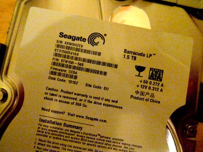

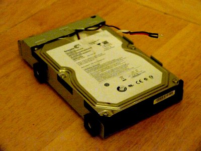

The 1.5TB 3.5" internal hard drive is a Seagate Barracuda LP ST31500541AS. It is only 5900 RPM and isn't useful for video streaming as I had originally intended. So I swapped the drive out with a 7200 RPM version.

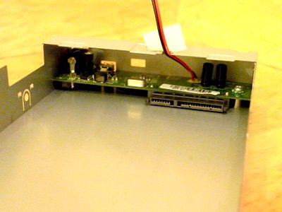

In order to pull the hard drive out of the metal enclosure, you have to unscrew the four rubble padding along the two sides. Once you slide the drive you, you will see the SATA to USB adapter. It is mounted to the metal enclosure.
