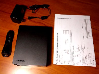

The Toshiba Canvio Desktop External Hard Dive comes in a big red box (see photo above). It's well packed with lots of air cushion around it to prevent damage. The retail box includes the black external hard drive itself, an instruction sheet, a SuperSpeed USB 3.0 cable, and the AC adapter as shown in the photo below.

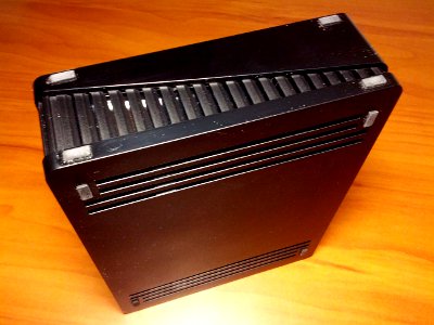

The external enclosure is made out of plastic. As shown in the photo below, there are enough rubber feet to allow it to stand up right, or sit horizontally. It's box like shape allows you to stack multiple drives on top of each other. And there are tons of ventilation slits to cool the drive.

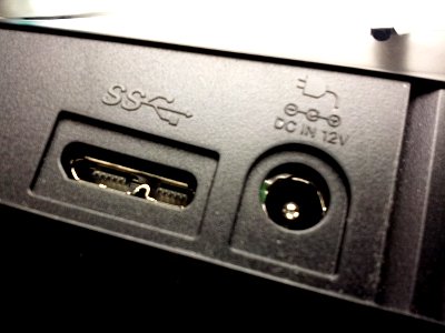

The hard drive enclosure only has two ports: 1) the SuperSpeed USB 3.0 port and the AC power port. As shown in the photo below, the AC port is 12 volts with a positive center. The SuperSpeed port is labeled with the SS logo. Not show in the photo is a single blue LED shows whether the drive is on or off.

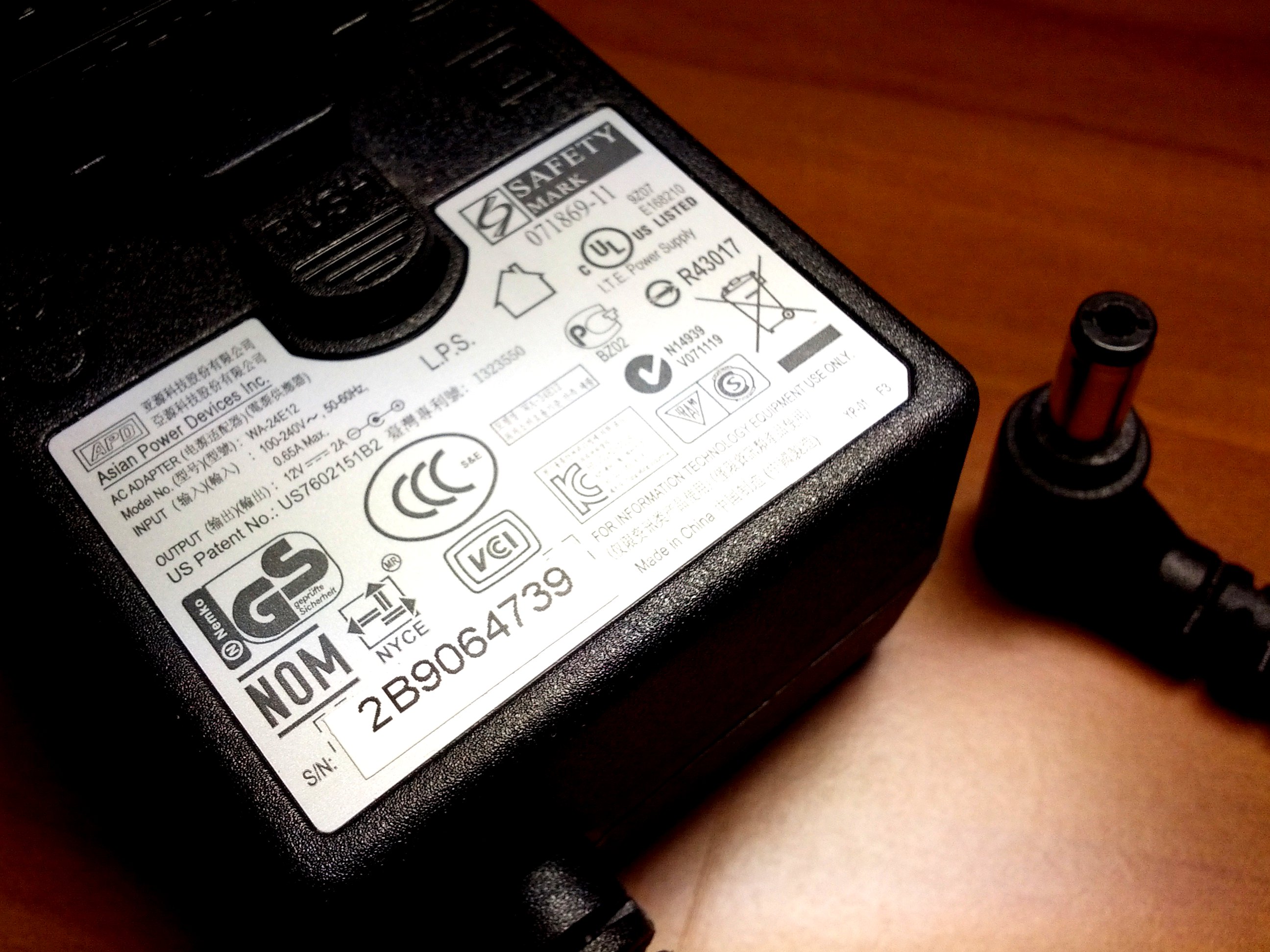

The AC adapter has the ability to supply 12 volts at 2 amps (label shown in photo below). It works with voltage all over the world. However, the version I got only has a power plug for the United States.

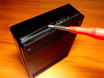

There are no screws anywhere on the case. They are not under any rubber feet, nor are they under the label. Instead, the case is snapped together with locking tabs. It's obvious that the manufacturer didn't intend you to open it.
Use a small flat-head screwdriver to pry between the seams on the top of the drive (see photo below). Because they are locking tabs, you will break off several, if not all, of the tabs to open the case. Apparently Toshiba had made this enclosure non-serviceable.

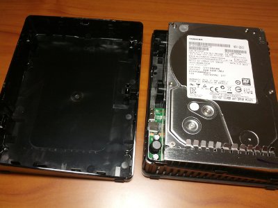

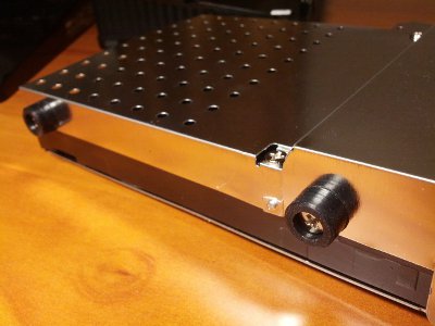

Inside the large plastic enclosure is the hard drive, mounted to a thin heat sink (see photo below).
The hard drive is easy to remove from the plastic case. Two screws at the bottom of the heat sink secures the drive and the SATA/USB adapter. Four additional screws on the rubber damper securely mounts the drive to the heat sink. Unscrew the screws shown in photo below to separate the hard drive from the heat sink.

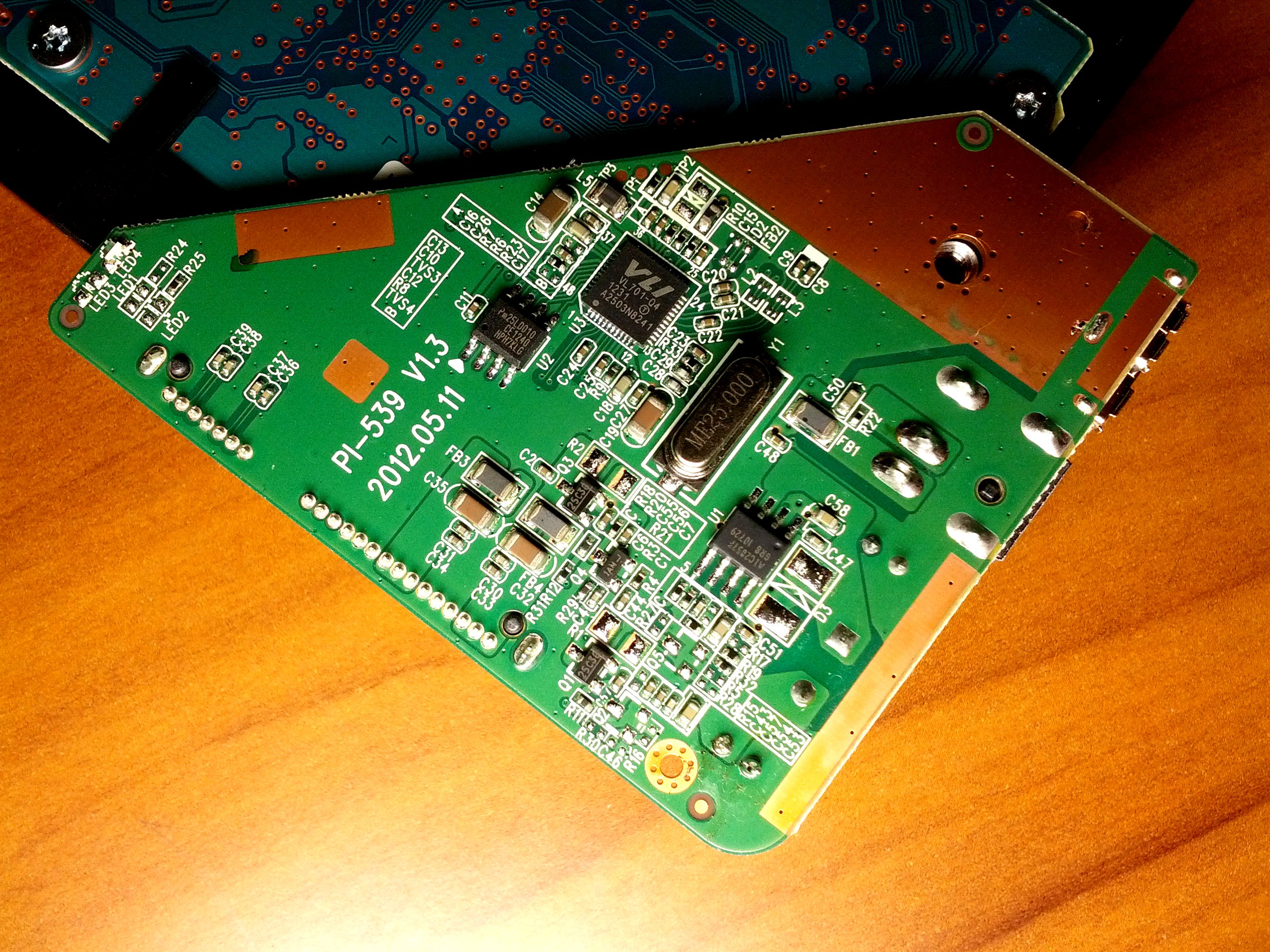

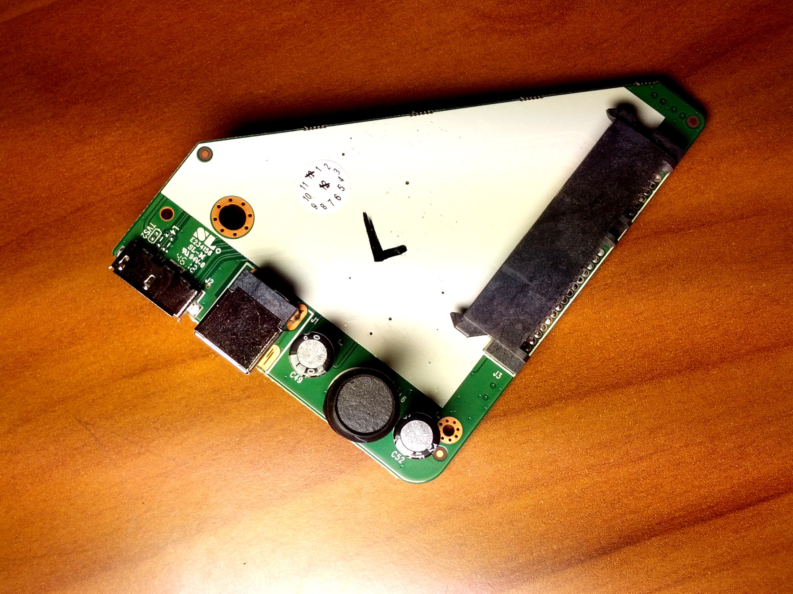

SATA/USB Adapter
The following two images shows the SATA/USB adapter. It's a small triangular adapter that can be easily secured onto a hard drive with a single screw. It can come in quite handy when you just want to use the adapter without the case.

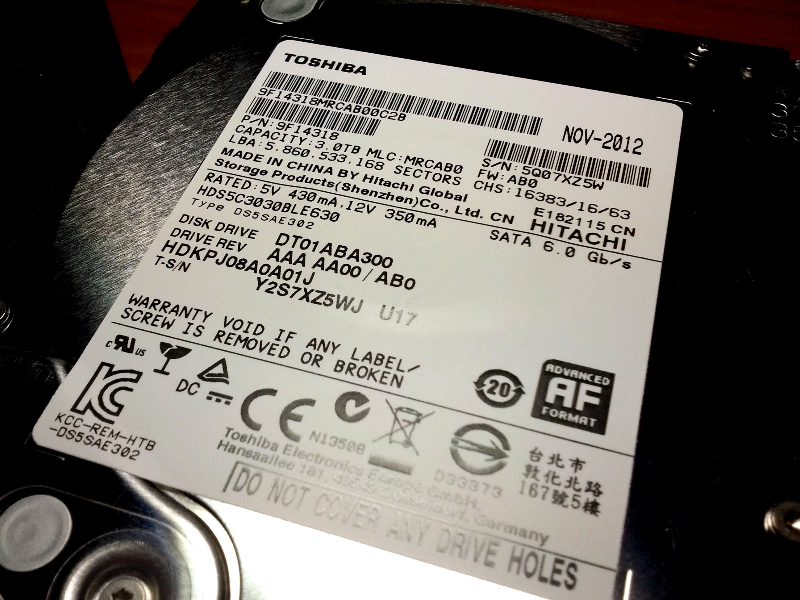

Internal Hard Drive
The 3TB 3.5" internal hard drive is a Toshiba DT01ABA300. The following are the basic specs from the Toshiba web site:
