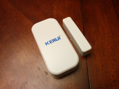

The KERUI wireless door / window sensor comes in two parts (see photo below). The larger part has the KERUI name on it. It also contains the electronics and the battery. The smaller part is the magnet. The purpose of this sensor is to detect that a door or window has opened. And it does this by sensing the separation of the two parts. When the two parts are separated, the larger unit lights up an LED behind the white plastic, which you can see. Then it sends a signal to the alarm panel.

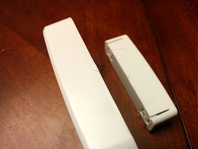

It is important how you align the two units. Each unit has a small triangle indicate the alignment mark (see photo below). In reality, only the larger unit is non-symmetrical. That means the triangle side on the larger unit has to be pointed toward the smaller unit. The smaller unit on the other hand is practically symmetrical. That means as long as the long side of the smaller unit is against the triangle side of the larger unit, the sensor will work as intended.

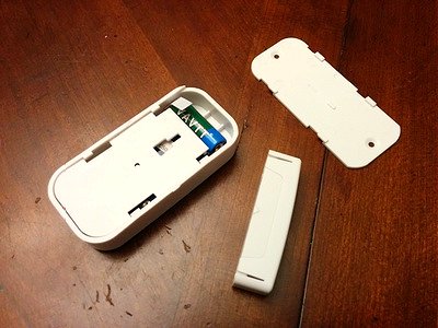

Once the KERUI door / window sensor is secured into place, you can slide it upward to separate it from the back panel, revealing the battery compartment (see photo below).
There is no power switch on the door / window sensor. The only way to turn it off is to remove the 23A battery.
