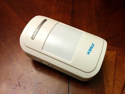

The KERUI wireless PIR motion detector detects motion using IR radiation that is given off by a warm body. It's fairly large, but has a decent, non-flamboyant look (see photo below).

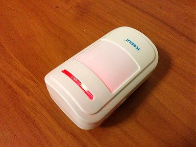

When the wireless PIR motion detector detects motion, it lights up the red LED on top and sends a signal to the alarm panel. The photo below shows the red LED.

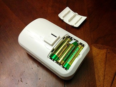

The KERUI Wireless PIR Motion Detector is powered by three AAA batteries. There is a battery compartment on the back of the motion detector (see photo below).

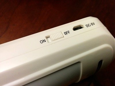

In addition, there is a way for you to power it with an AC adapter on the left side of the unit (see photo below). The power port is a standard micro-USB port that used on today's SmartPhones. A power switch allows you to turn the unit on and off.
After leaving the motion sensors on 24/7 for the last 3.75 months, one of the motion sensors finally ran out battery. This is using Alkaline batteries. Interesting, it stays on when the battery is low; the light stays lit and if your alarm is active, it will trigger the alarm. The one that ran out of battery first is the dining room one. This one is most active, because it is the room that gets the most activity. Our other motion sensors haven't ran out of battery yet. It's been eight months now, and the less active sensors haven't run out of battery yet.
I have replaced the AAA Alkaline batteries with rechargeable NiMH batteries. But after only nine days, the rechargeable NiMH batteries are already out of juice for this highly active area.

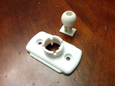

The KERUI wireless PIR Motion Detector comes with a ball joint swivel mount (see photo below). KERUI intends you to mount the motion detector to a specific height on the wall.
For home use, I found that to be somewhat intrusive. Instead, I have several locations around the house where the height is about right. I just place the motion detector at these locations. Luckily the motion detector stands well on its own.
In the dining room, I placed it on top of the fireplace. In the living room, I placed it on top of a tower fan, which has a nice concave top that is perfect for it. In my home office, I placed it on a shelf. In the garage, I also placed it on a shelf.
