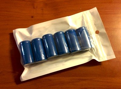

One of my biggest concerns with electrical gadgets today is whether they work with rechargeable batteries. Fortunately, Netgear Arlo cameras do work with rechargeable batteries. The form-factor for CR123 size batteries are RCR123A and 16340, so look for this size battery with either Li-Ion or LiFePO4. Netgear specifies at least 650 mAh and as much as 2000 mAh. It's unclear why you can't get even higher capacity batteries. Netgear Arlo cameras can handle single battery voltage up to 4.2v.

2015-10-30: I ordered rechargeable batteries (see photo above) from Amazon. They are 16340 3.7v 2000 mAh Li-ion ones (see "Related Links" below). I charged them up with my Nitecore Intellicharger I4 and installed them into the Backyard Gate camera last night. They powered the camera just fine. I will continue to update this web page as the batteries in the camera depletes.

2015-11-06: New rechargeable batteries for the Front Door camera arrived yesterday from Amazon. After fully charging them, I installed them tonight.

2015-12-07: Arlo sent me an e-mail saying that the Front Door camera is running low (14%). These rechargeable batteries were installed on 11/6. So these rechargeable batteries lasted only one month, whereas the Alkaline batteries lasted six months.
2015-12-10: Arlo sent me an e-mail saying that the Backyard Gate camera is running low (15%). These rechargeable batteries were installed on 10/30. So this set lasted a month and ten days.
2015-12-14: I finally replace the Front Walkway camera battery with rechargeable batteries. I will report how long this set lasts, but it's probably going to be about the same time frame as the other two cameras.
2017-12-17: I've been using rechargeable batteries for the past two years. And they have constantly require changing every month. And the rechargeable batteries don't seem to be protected from over-discharge. Therefore, they die if you leave them in the Arlo camera too long. I would prefer the batteries to last longer than a month, so I don't have to constantly rotate them. I could live with rotating them every month if they don't die. But I have not found any good rechargeable batteries that's up for the task. So I'm switching back to non-rechargeable Lithium batteries (see "Related Links" below).
