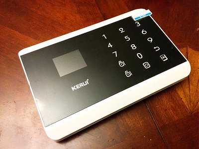

I don't know if the photo above is an artist render or a very good photographic trick. Because after getting the alarm panel, I have found that I been had. Seeing the panel in person (see photo below), it doesn't look as space age as the photo on Amazon. But its aesthetics is a minor draw back in the system as a whole. From a distance, your mind can still make you think it's quite futuristic
The buttons are actually touch sensitive. You use it like a modern age tablet. Just an assertive touch on the button activates it without having to push with any force at all.

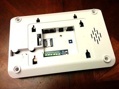

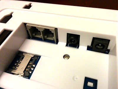

The back of the panel provides a number of connectivity to the outside world (see photo below). It's recessed so that you can mount the alarm panel flush to the wall.
Photo below shows a number of ports toward the top of the alarm panel. From the left to the right: 1) telephone port; 2) telephone company port; 3) wired siren; 4) power. The GSM sim slot is toward the left center of the panel. You can plug an activated GSM sim card into it so that it can call the outside world through the mobile network. More importantly, it can send you text messages.

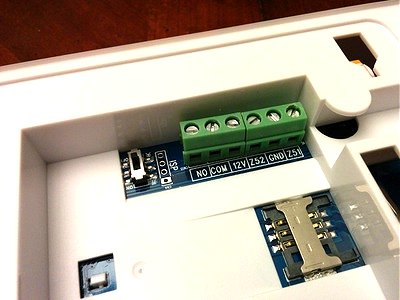

The following photo shows the connectivity ports toward the bottom of the alarm panel. First of all, a switch toward the top left of the photo is the on/off switch. Then there are a number of electrical connectors for traditional security system connections.

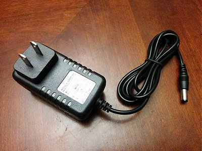

Power Adapter

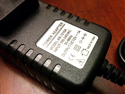

The alarm panel comes with a two-prong power adapter (see photo below).
The specification for the power adapter is as follows:
Model: KR-1210A
Input: 100-240VAC
Output: DC 12V 1A
Positive center

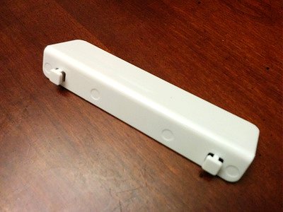

The alarm panel comes with two mounting panels. The first mount panel (see photo below) covers the connectivity ports. The thin plastic that sticks out of the panel toward the right-side of the photo activates a switch inside the alarm panel. When the alarm panel and the mounting panel separates, an alarm is triggered.

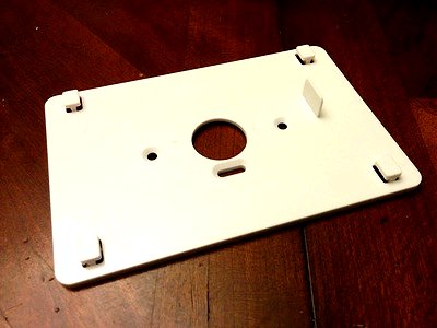

The second mount panel (see photo below) allows the alarm panel to sit at an angle.
