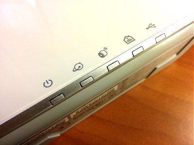

There are five LED's on the front of the base station. Each of them lights up green when operating correctly. The first LED is the power indicator. Second LED is the Internet indicator. The third LED shows wireless cameras are connected. The fourth LED is the "Smart Home" indicator. The fifth LED is the USB indicator. The instruction manual doesn't explain the "Smart Home" nor the USB indicators.

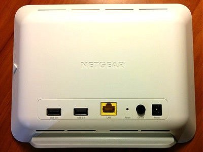

Other than the network port, the base station has several other connectivity ports on its back (see photo above). There is a triangle sync button on the left side, two USB ports, a reset hole, the power button, and the power port. It's unclear what the USB ports are going to be used for.

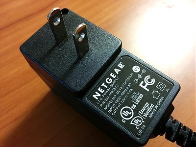

Power Adapter
The base station power adapter is two prong. Therefore, it's easy to find an AC outlet for it. And it's angled side ways so that it won't cover the next outlet on a power strip.
The following is the specs for the power supply:
P/N: 332-10653-01
Model No: ML18-7120150-A1
Input: 120V ~ 60 Hz 0.5A
Output: 12 V 1.5A
Positive center on the connector.
