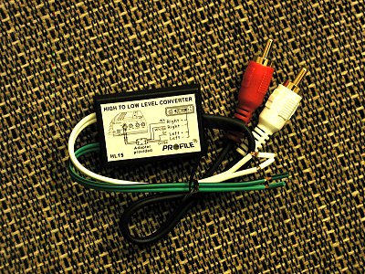

I have gotten the Profile California AP400 several weeks ago and installed it. It's working well. What surprised me is that rather than include an integrated line level converter in the amp, Profile packaged a separate external line level converter (see photo below). I guess this way, if you burn out the line level converter, your amp still works.
Knowing this, it was tempting for me to continue the line level converter input. But I finally decided against it. Instead, I finally pulled the RCA preamp cable through my car.
