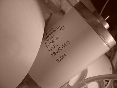

Wayne Dalton idrive for Torsion Springs - Motor Specification
CIM
WD801-003B
120Vdc
E-186696
306953
PB-25L-0013
112904
Sun, 17 Jun 2007 12:59:46 -0700
where can i get a replacement motor. mine seems to be interrmitment
brand j moffatt
Fri, 25 Mar 2011 21:35:26 +0000
Try profiling first. If that doesn't work, then consider a new motor.
Sat, 26 Mar 2011 19:04:31 +0000
The motor cable flexing may create a break in the motor power leads, not much you can do about that. Always remove the power if you get up there to look it over.
I have seen a few conditions were the door would stop or stop/reverse after about one year of operation. -Mine.
The solution was to re-lub the motor shaft, There are two hex screws that hold the motor and found on top of the motor. Easy to get to with the motor pivoted down.
Always unplug the power, don't want somebody starting the operator and your there with the motor dropped down out of the gear box.
Remove the two screws, motor will drop out, you may have to pull on it a little and then lube it with royal jelly, put motor back into the gear box - don't forget the screws. Power up and run the door up/down a few times. For lubes, if your up north, look for a lube that won't freeze up if the garage is not heated. Slick 50 was great but it's no longer sold.
On my I-drive, about every six months now, the operator starts having problems, I pull down the motor, lube it up and in an instance it back to normal. No more work. I expect it just like changing the oil in the car.
I have suggested they add a lube section to their manual, but they instead want to send out new motors.
