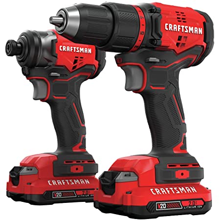

Craftsman V20 Power Tools Battery Conversion Guide
Looking for a Craftsman V20 battery adapter to use other brands' battery packs on your Craftsman V20 power tools? You came to the right place. This page provides recommendation of battery adapters and various methods for you to do just that.
