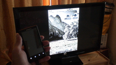

Recently, the LCD on my Motorola Triumph Android phone died. After spending an afternoon contemplating what to do to get my data off it, I realized that it has a HDMI output. I plugged it into my Panasonic 50" plasma HDTV and turned both devices on. And I was presented with the Android locking screen. Surprisingly, even though the LCD had died, the touch input still works; I can still control the Android phone with the dead LCD.

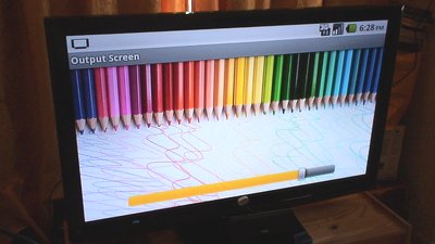

When the Android phone is plugged into the HDMI port of your HDTV, it will display the largest screen size possible. On some televisions, such as mine, it is much bigger than what the TV can display.

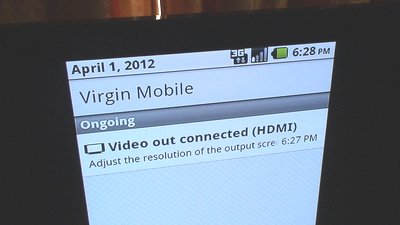

In the notification bar, you will see a display icon once the phone is plugged into the television. Drag down the notification bar and tap the display entry will allow you to adjust the screen size. Use the scroll bar at the bottom of the display app to resize the display to match your TV.
The custom setting lasts for the duration that the phone is on. It also last through sleep mode. However, if you turn the phone off, you'll have to resize the display the next time you turn it on and plug it into the TV.
