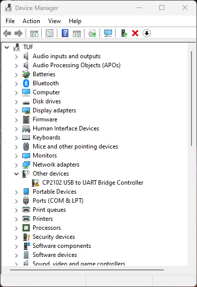

  7. Look under "Other devices" category in "Device Manager" and see if "CP2102 USB to UART Bridge Controller" shows up (see screen shot below). If so, you have a proper data cable. But you are missing the device driver for the Heltec V3 board. If you don't see that entry, see next step.

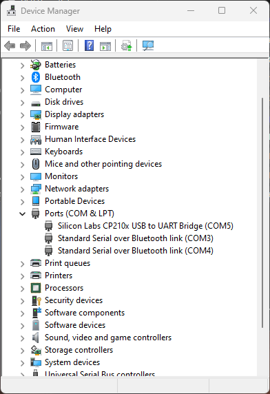

  8. Look under "Ports (COM & LPT)" category in "Device Manager" and see if "Silicon Labs CP210x USB to UART Bridge (COM5)" shows up (see screen shot below). The "COM5" could be any COM port available on your computer. If so, you have the proper data cable and the proper device driver.
