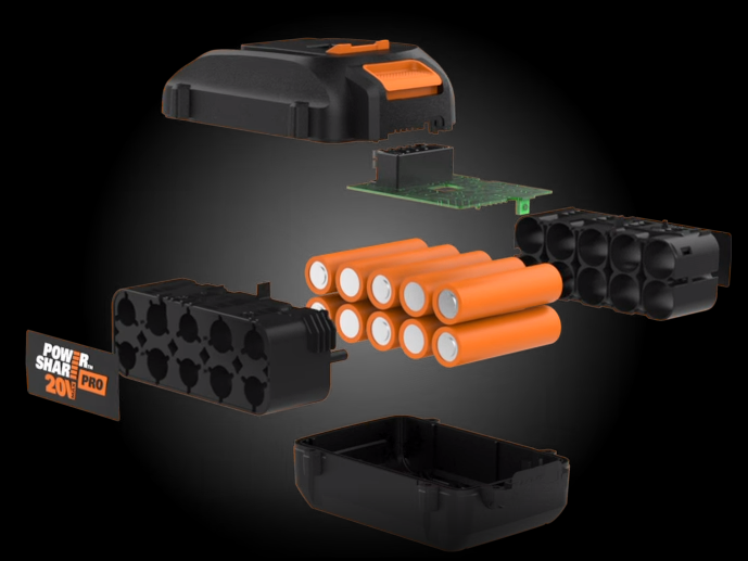

Notes on 18V/20V Lithium Ion Battery Packs
Most, if not all, 18-volt and 20-volt lithium ion systems uses five 3.6-volt lithium ion battery cells (connected in series) to create the battery pack. Five 3.6 volt batteries provides 18 nominal volts. The battery pack provides 20 volts when fully charged.
To increase the capacity of the battery pack--4 Ah vs. 2 Ah--manufacturers would add five more cells, connected-in-series, to the battery pack in parallel to the first five cells.

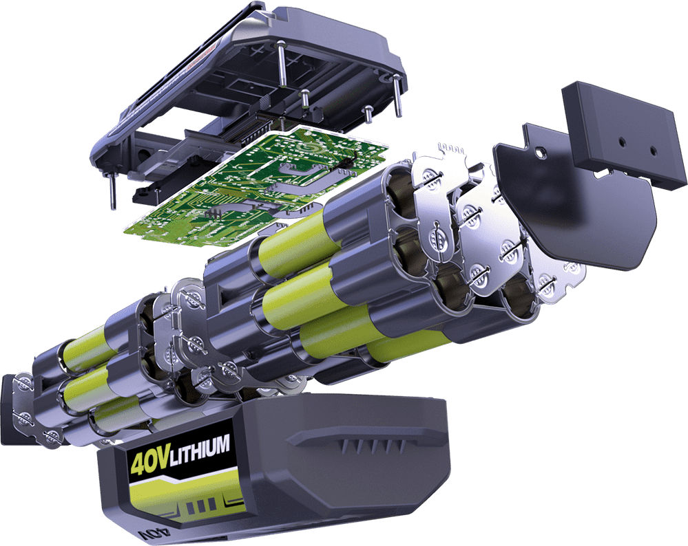

Notes on 40V Lithium Ion Battery Packs
Most, if not all, 40-volt lithium ion systems are practically two 18V/20V battery packs connected in series. In fact, that's how WORX is marketing its Share Power battery packs and power tools. The 40V battery pack provides 36 nominal volts and provides 40 volts when fully charged.
