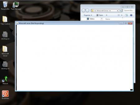

So I have been running Minecraft server 1.8.1 on various computers to test performance. One strange phenomenon is that the Minecraft server GUI does not respond on AMD CPU's (see screen shot below). It basically doesn't update. And when you click on it, Windows reports that it is "Not Responding" in the title bar.
Funny thing is that the server actually runs just fine. I can play in the server's Minecraft world. And the state is saved correctly on the server.
This problem doesn't occur on any computers with the Intel processor. But both of my notebook computers with the AMD processor has this problem. One of the notebook is the HP Pavilion Entertainment Notebook PC DV7-3160us, which has the AMD Turion(tm) II Ultra Dual-Core Mobile M620 (2.5 GHz) processer. The other notebook is the Acer Aspire One 722-BZ454 with the AMD C-60 APUwith Radeon(tm) HD Graphics (1.0 GHz).
I seem to recall seeing this problem when running Java GUI's on AMD processors. And Minecraft server is Java-based. Has anyone else experienced this problem before?
