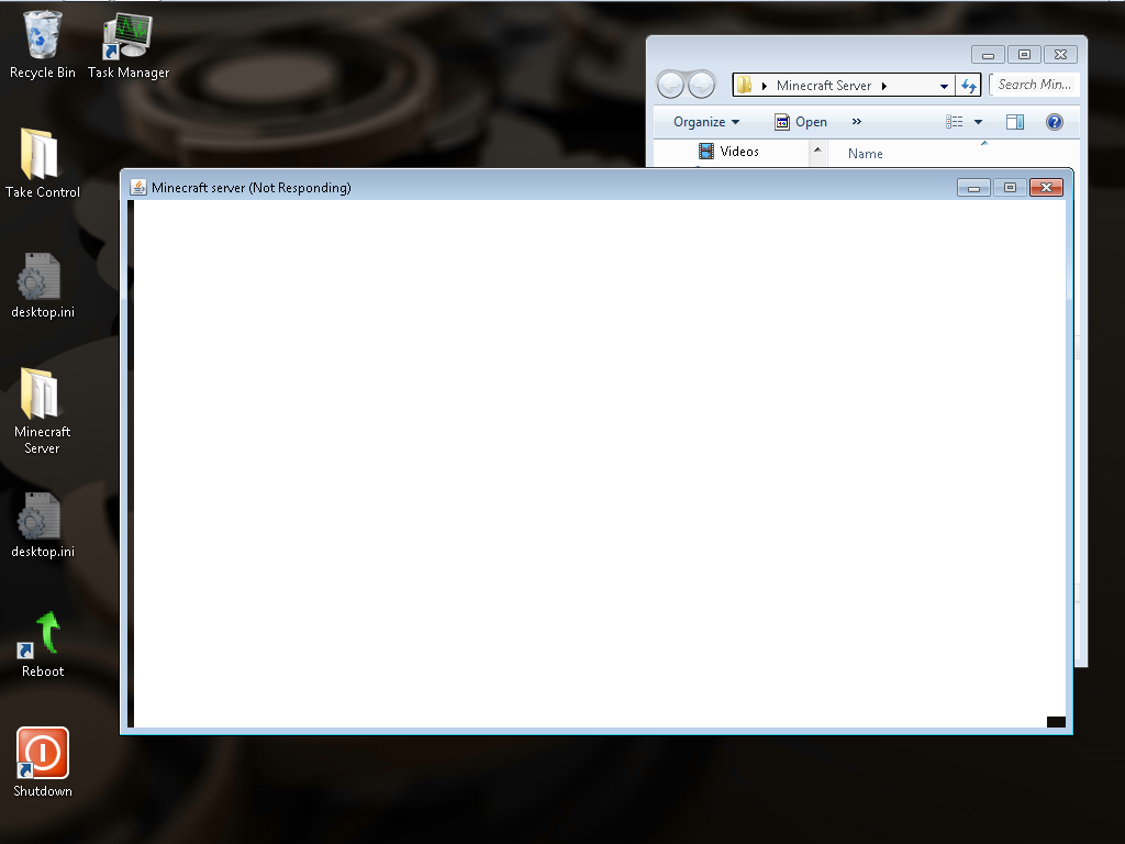

Ok, here is a problem that has been plaguing me forever and I finally figured it out today.
The problem: When I run a Java GUI on Remote Desktop, while the Remote Desktop server uses AMD CPU, the Java GUI does not display and Windows claims it is not responding. The following screen shot is an example of running the Minecraft server (Java):
I have tested this symptom on two separate AMD CPU notebook computers and this failure occurs on both. The exact models of the computer is documented in "Minecraft Server GUI Does Not Respond on AMD CPU".
You can also perform this test from a pure Java GUI utility, such as the OK Dialog (Freeware).
After doing some digging today, I came across the "-Dsun.java2d.d3d=false" flag. I tried it with "OK Dialog" using the following syntax on the AMD server remotely and it works:
  java -Dsun.java2d.d3d=false OKDialog "hello" "world"
On the Oracle Troubleshooting Guide for Java SE 6 Desktop Technologies web page, it says, "-Dsun.java2d.d3d=false – Disable the use of Direct3D pipeline." It sheds light on things, but it's not clear why the Direct3D pipeline doesn't work on AMD processors.
So now, I have the solution to run Java GUI over Remote Desktop on AMD CPU... But it doesn't help when the Minecraft server is an Windows executable. Looks like I will have to try the JAR version of Minecraft server.
